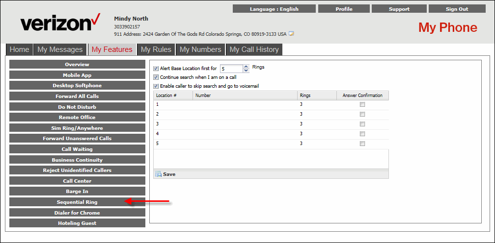

D. Feature Setup

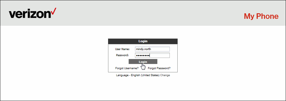

  1. Log in to the My Phone dashboard at https://businessdigital.verizon.com/myphone/control/login
  2. Enter your User Name and Password. Use the login information provided by your administrator.
  3. Click Login. The My Phone home page appears.

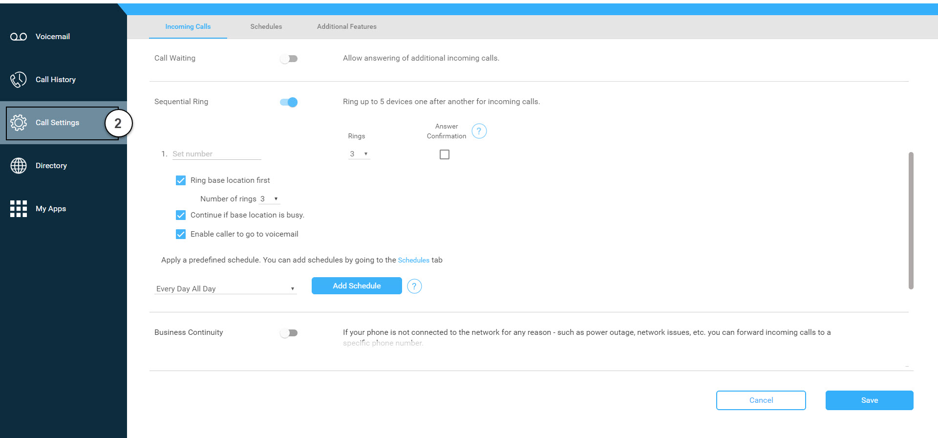

  1. Click My Features at the top of the page.
  2. Click Sequential Ring on the left.

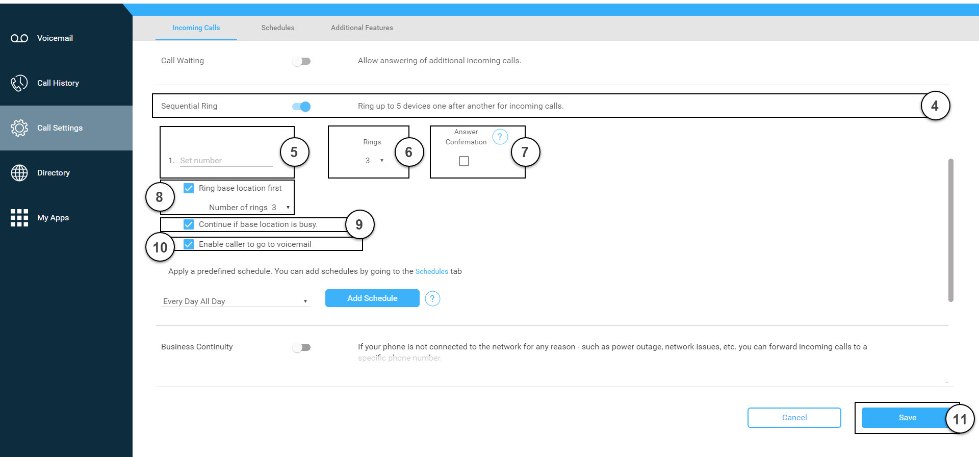

  3. Check Alert Base Location first for __ rings, if applicable. When checked, your base location rings first before the other locations are tried. If not checked, your base location will not ring, and Location # 1 is tried first. This also sets the number of rings at your base location before ringing your other locations. The maximum number of rings is 20. Note: changing this setting also changes the settings for rings before voice mail and the number of rings for forwarding unanswered calls.
  4. Check Continue search when I am on a call, if applicable. Calls are sent to your list of alternate locations if the Alert Base Location first for __ rings setting is also checked, and you’re on a call or your phone is unreachable.
  5. Check Enable caller to skip search and go to voice mail, if applicable. Callers can press # to interrupt the search.
  1. Enter a list of 10-digit numbers or E.264 International numbers to be rung in order from 1 to 5.
  2. Double-click on a number in the Rings column to set the number of rings for each number (20 maximum).
  3. Check Answer Confirmation for each number you want. Answer Confirmation requires that the called party to press 1 on the keypad to receive the call. If the 1 is not entered, the call continues through the list of sequential numbers. This feature prevents calls from being placed into the voice mail of the alternate sequential numbers.
  4. Click Save.

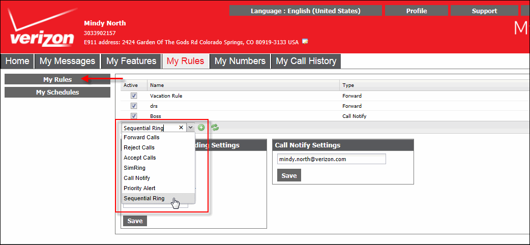

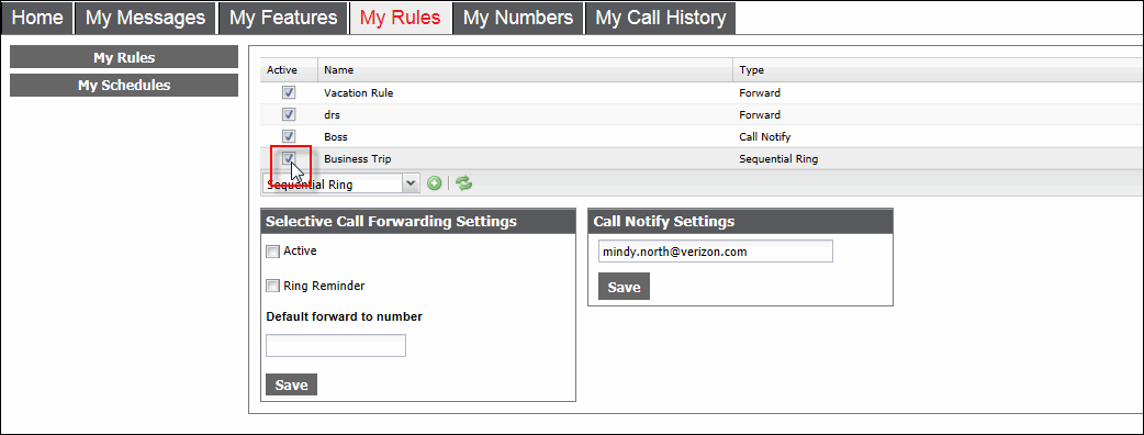

  5. Click My Rules at the top of the page to create a rule for Sequential Ring. Note: This feature will not work without a configured and activated rule.
  1. Select Sequential Ring from the drop-down list.
  2. Click the plus sign The Sequential Ring pop-up appears.
  3. Enter a Rule Name. The Action of Use Sequential Ring is automatically selected.

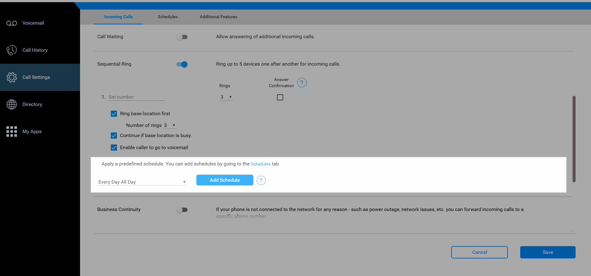

  4. Select a Time Schedule or a Holiday Schedule from the drop-down list. Note: If you do not have any schedules, close this screen and click My Schedules on the left on the My Rules screen to create one. You can create the time schedules or holiday schedules you need. Follow steps 14-15 to access the Sequential Ring pop-up to continue creating your rule.
    • Time Schedules - set a time of day and day of week schedule.
    • Holiday - set the days and times for holidays.

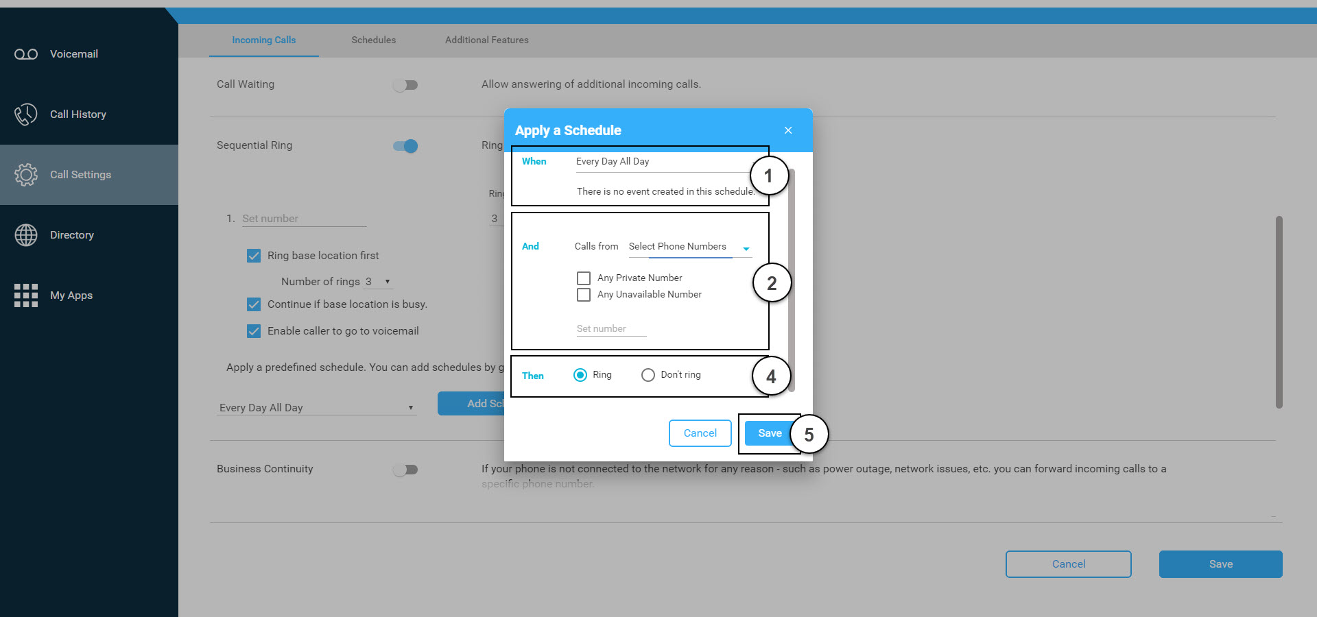

  1. Select Any external phone number if you want all calls from all numbers to follow this rule.
    -OR-
    Select Following phone numbers to specify certain numbers to which this rule applies.
    • Check Any private number if you want all calls from private numbers to follow this rule.
    • Check Any unavailable number if you want all unavailable numbers to follow this rule.
    • Add a list of up to 12 numbers you want to follow this rule.
  1. Click Save. The Sequential Ring pop-up closes, and the My Rules screen reappears.
  2. Check the Active box next to the rule to enable it.
