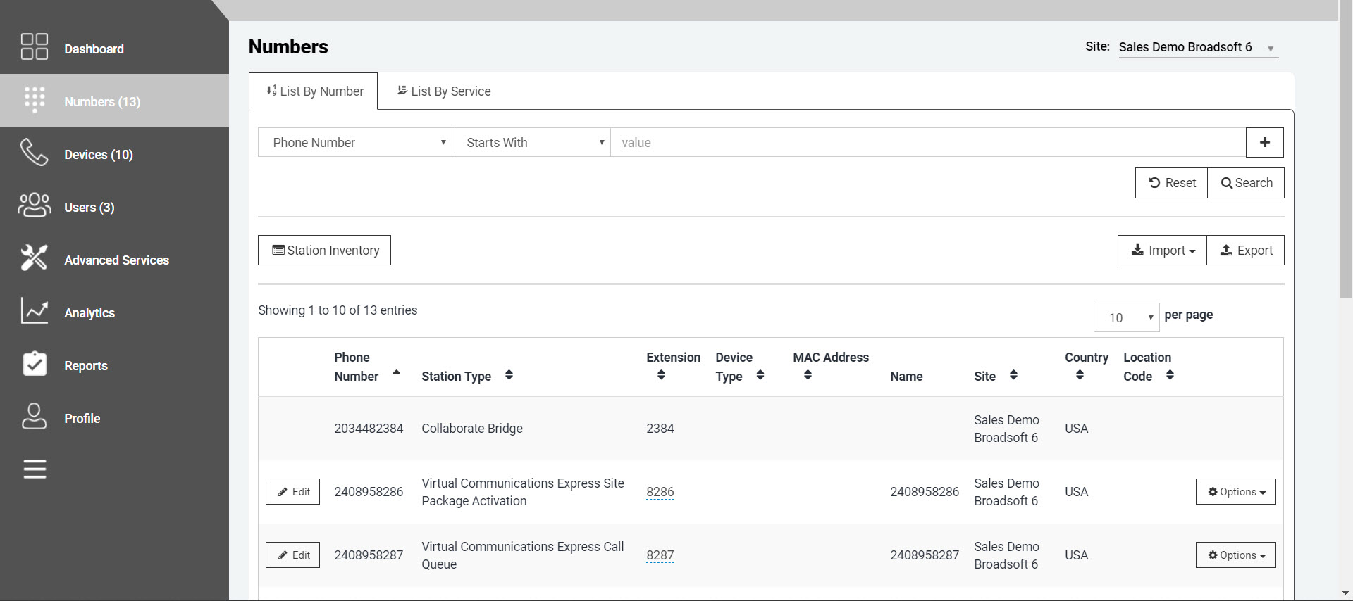

  1. Log in to the Enterprise Portal.
  2. Select your Site from the drop-down menu.
  3. Select the Numbers tab.
From here, you can assign phone numbers, modify extensions, assign stations (phones) to users, and modify the user’s first and last name.
The following describes the Lists type on the Numbers tab:
  • List by Number – Provides a list of phone numbers associated with each user.
  • List by Service – Provides a list on the type of service assigned to each phone number.

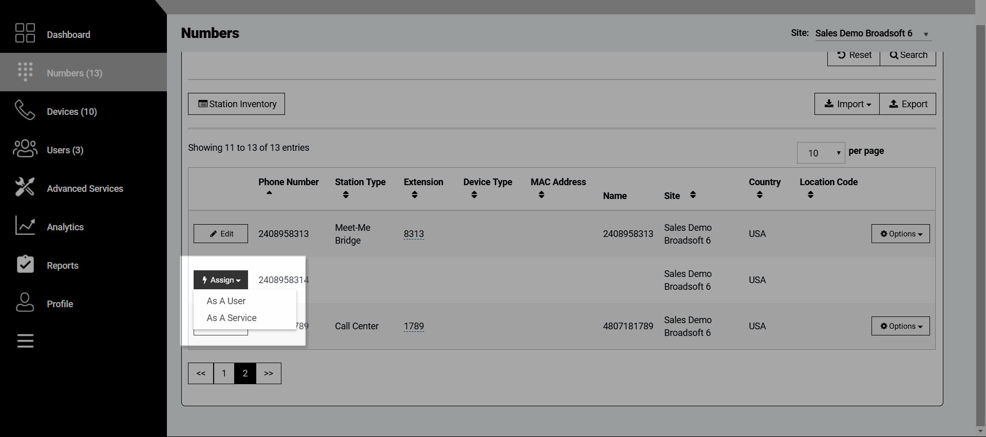

  1. Choose the List By Number tab and select the Assign drop-down next to the Phone Number to which you want to assign the station.
  2. From the drop-down, select As a User.

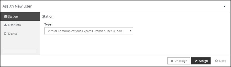

  1. The Assign New User window appears.
  2. Select the Station tab, select the station Type from the drop-down list. Reference your Order Summary to verify the station type you should select.
  3. Select Assign.
  4. Then select Next to advance to the User Info tab.

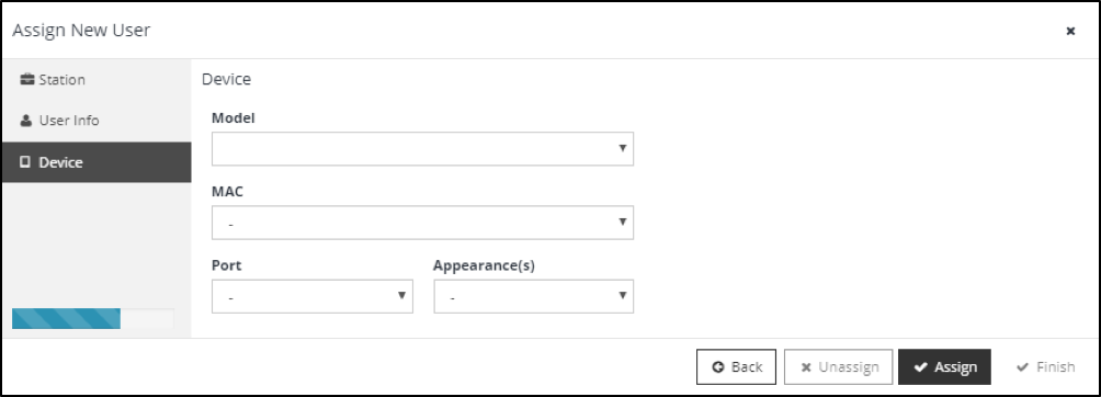

  7. Click Next to the Device tab.
  1. Select the phone model from the Model drop-down list.
  2. Select the MAC Address. This must match the MAC address on the device you are assigning.
  3. Select 1 from the Port drop-down list.
    • For VoIP phones, the Port Option will typically display as “Port 1”
    • For Analog Telephone Adapters (ATAs)
      • Record the Telephone Number that has been assigned to each ATA port.
      • Select Port on the ATA that this phone number is assigned to.
  4. The system will determine whether the selected device can support multiple lines. If so, select the desired number of Line Appearances under Appearance(s).
  5. Click Assign.
  6. Finally, select Finish.
