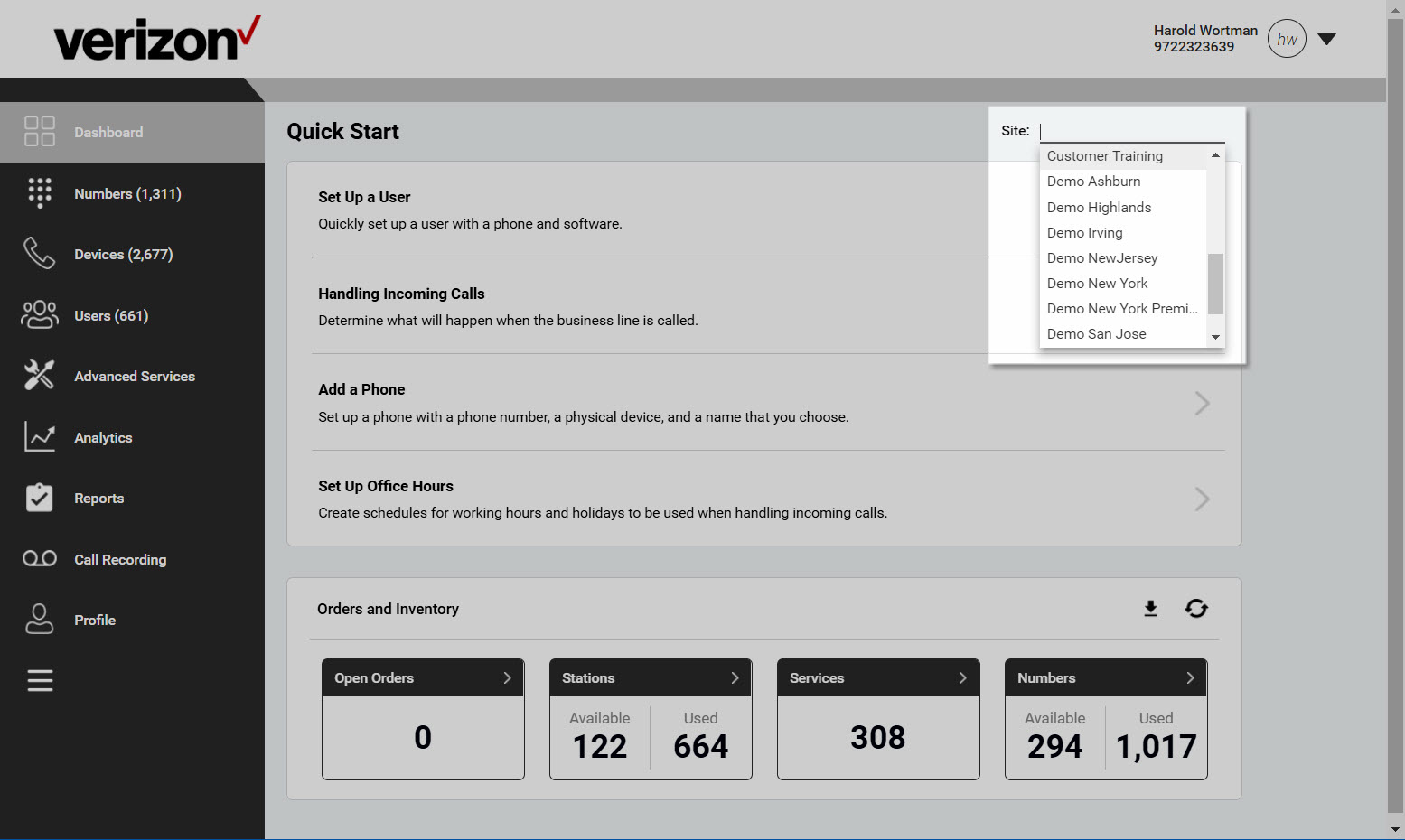

  1. Log in to the Enterprise Portal.
  2. Select your site from the drop-down menu.

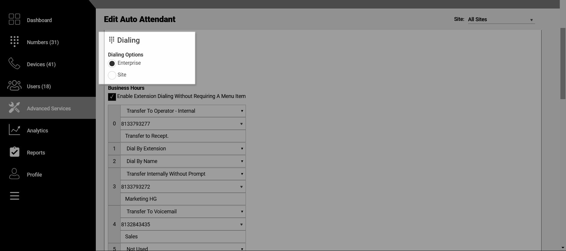

  4. Under Dialing, select a dialing options: Enterprise or Site.
    • Enterprise - Callers who reach the Auto Attendant and choose to dial by name or extension can reach any user at any location within the entire company. Note: User’s with Privacy enabled may not be listed in the name or extension directory or may not be dialed.
    • Site - Callers who reach the Auto Attendant and choose to dial by name or extension can reach any user located at the specific site associated with this Auto Attendant.

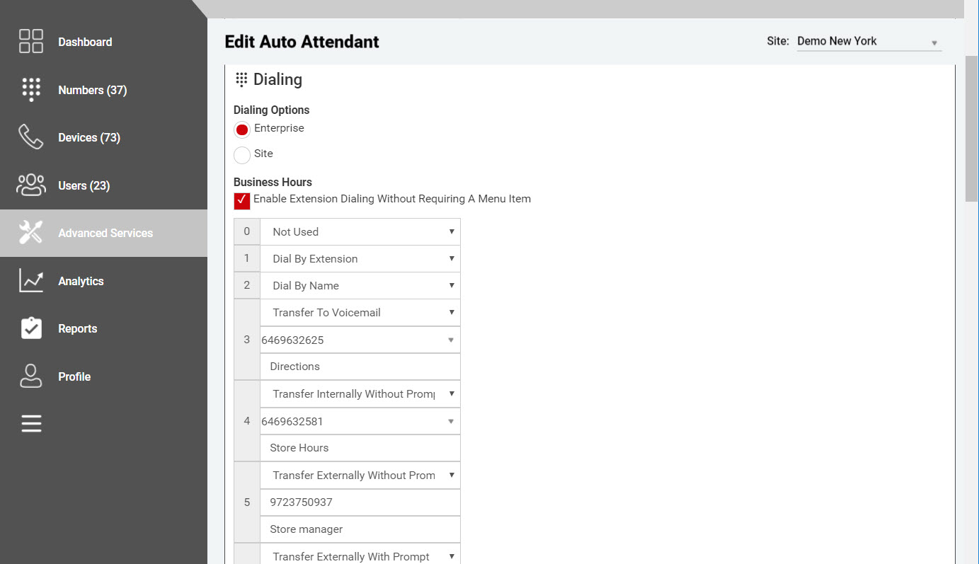

B. How do I modify the dialing menu for Business Hours and/or After Hours?
  1. Here you will configure the business hours and/or after hours menu. You will determine which action the Auto Attendant will take when an incoming caller chooses a particular number of symbol on the keypad.
  2. The keypad numbers that can be configured include numbers 0-9, star (*) and pound (#).
  1. Select the action for business hours from the drop-down list.
    • Not Used: This is the default when an action has not been selected for that digit or character.
    • Transfer Externally with Prompt: This action routes callers to a phone number that is not a User or Extension within the company. For example: A third-party answering service or corporate call center.
    • Transfer Externally without Prompt: This action routes callers to a phone number that is not a User or Extension within the company. For example: A third-party answering service or corporate call center.
    • Transfer to Operator - External: This will redirect callers to a configured operator, who will receive all calls that “time out” when a caller does not choose an option from the Auto Attendant. You will enter the phone number to which to route callers here.
    • Transfer to Operator - Internal: This will redirect callers to a configured operator, who will receive all calls that “time out” when a caller does not choose an option from the Auto Attendant. You can select from existing phone numbers in the system.
    • Transfer to Voicemail: This selection places callers directly into the Voicemail box of the Extension entered in the “Transfer To” Field. Please Note: This option will only transfer to an Extension Voicemail.
    • Transfer to Internal Number with Prompt: This will route callers to a selected User’s phone number within the company. As soon as the caller chooses this option, a prompt will play a message before the transfer is placed. It will include the User’s name as recorded in the Voicemail box.
    • Transfer to Internal Number without Prompt: This will route callers to a selected User’s phone number within the company. This option will route the caller as soon it is selected.
    • Transfer to Extension with Prompt: Callers are sent to a pre-configured User Extension. As soon as the caller chooses this option, a prompt will play a message before the transfer is placed. It will include the User’s name as recorded in the Voicemail box.
    • Transfer to Extension without Prompt: Callers are sent to a pre-configured User Extension. This option will route the caller as soon as it is selected.
    • Dial by Name: This action permits callers to dial by recipient name, using the letters on the Keypad.
    • Dial by Extension: This action lets callers dial by recipient Extension, using the numbers on the Keypad.
    • Repeat Menu: If selected, this action will repeat the Greeting and Menu options.
    • Exit Menu: This action allows callers to exit the menu system. This will terminate the call.
  2. Where applicable, in the 2nd field, choose the number to which the call should be transferred from the drop-down menu.
  3. Finally, in the 3rd field add the description (e.g. Customer Service).
  4. Repeat the same steps for your After Hours dialing menu, if applicable.
  5. Select Save to save your changes.

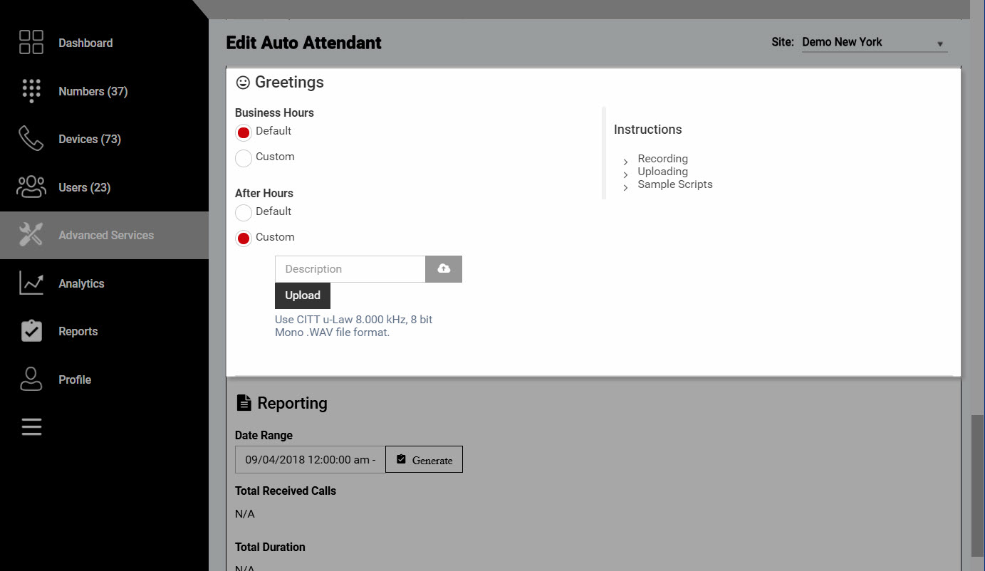

C. How do I modify greeting for Auto Attendants?
Auto Attendant Greetings are used to present callers with options to dial from on the Auto Attendant. These greeting can be customized and uploaded to the Dashboard or recorded from the Voice Portal. To modify the greeting for Auto Attendants:
  1. Scroll to the Greeting section on the Edit Auto Attendant page.
  1. By default, the system default greeting is assigned. Note: The default greeting states the following – “Welcome. You call is being answered by an automated attendant. If you know your party’s extension, Press one (1). To use our automated name directory, Press two (2). If you would like to speak to an operator, Press zero (0). Thank you for calling,”
  2. If you would like to add a customized greeting, choose Custom. There are 2 ways to add a customized greeting:
    1. Upload an already recorded custom greeting
    2. OR
    3. Record a Greeting from the Voice Portal
    1. Upload an already recorded custom greeting – To upload a custom Business Hours and/or After Hours greeting:
      • Enter a description for the .wav file.
      • Click the Upload from Computer Icon next to the description field
      • Choose the file from your computer and select Open
        • For greeting files to properly upload, they must be saved as a .wav file in CCITT u-Law 8.000 kHz, 8 bit Mono attributes with a maximum file size of 2MB. Using a basic sound converter allows you to save your .wav file in this format.
    2. Record a Greeting from the Voice Portal – To record your own personalized greeting from the Voice Portal:
      • Dial your Voice Portal number.
      • If initially prompted to enter your passcode, press * to return to the enter mail box ID prompt.
      • At the enter mail box ID prompt, enter the Voice Portal extension followed by #.
      • At the enter passcode prompt, enter the Voice Portal administrator passcode followed by #.
      • Note: If you do not have your default Voice Portal Passcode, you can set a new one. It must consist of numbers only.
      • Enter the new Voice Portal password.
      • Confirm the new Voice Portal password.
      • Click Save.
      • Press 1 to change Auto Attendant greetings.
      • Press 1 for Business Hours. Then record the greeting at the prompt.
      • Press 2 for After Hours then record the after hours greeting.
        • Each auto attendant includes a greeting option for After Hours callers. Repeat step 2 for the after-hours greeting.

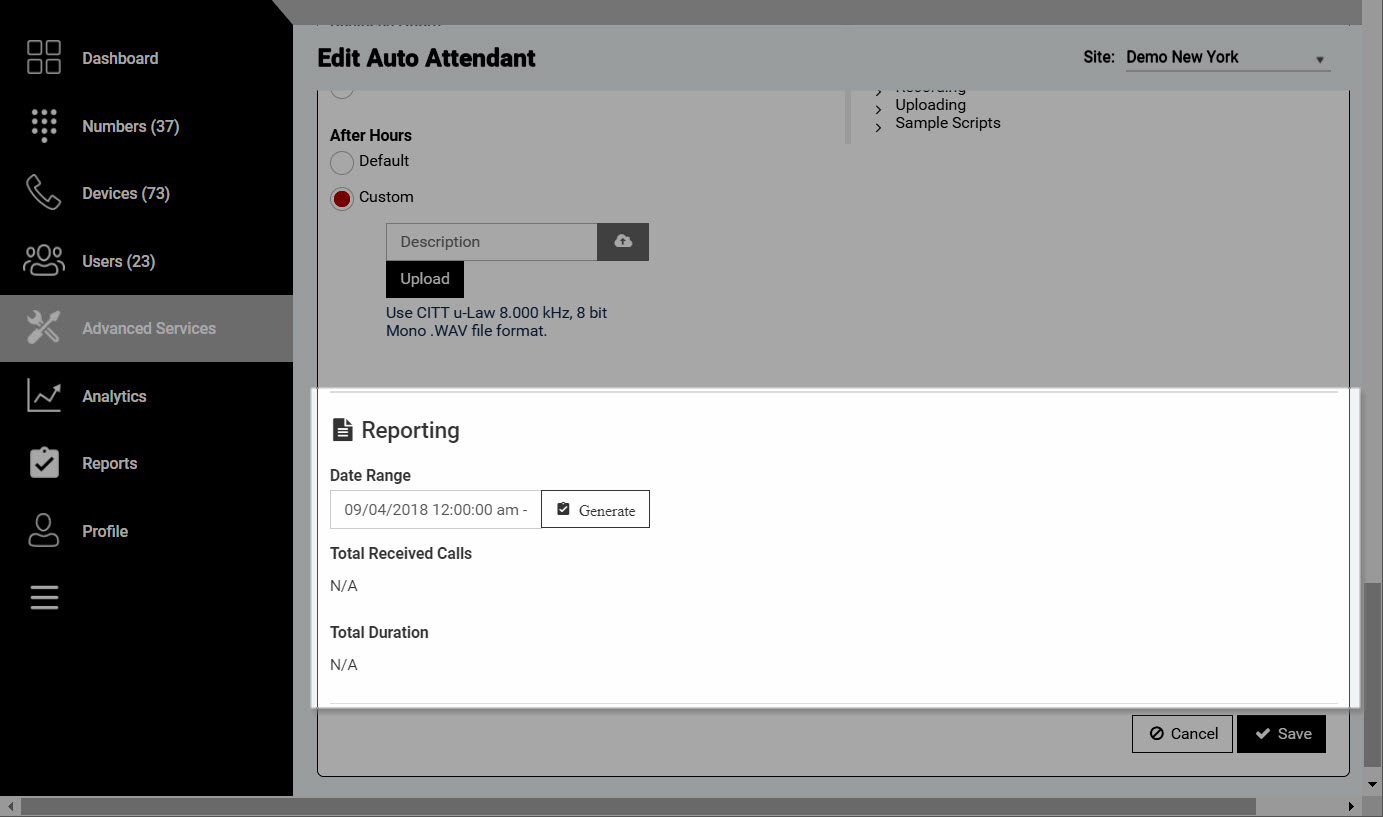

D. Reporting
Auto Attendant Reports show the complete Utilization totals for the Auto Attendant including Answered calls, Busy calls, Not Answered calls and Duration of Calls.
  1. Select the date and date range you would like to pull the report on.
  1. Select Apply.
  2. Select Generate. The report information will appear in a pop up window.
