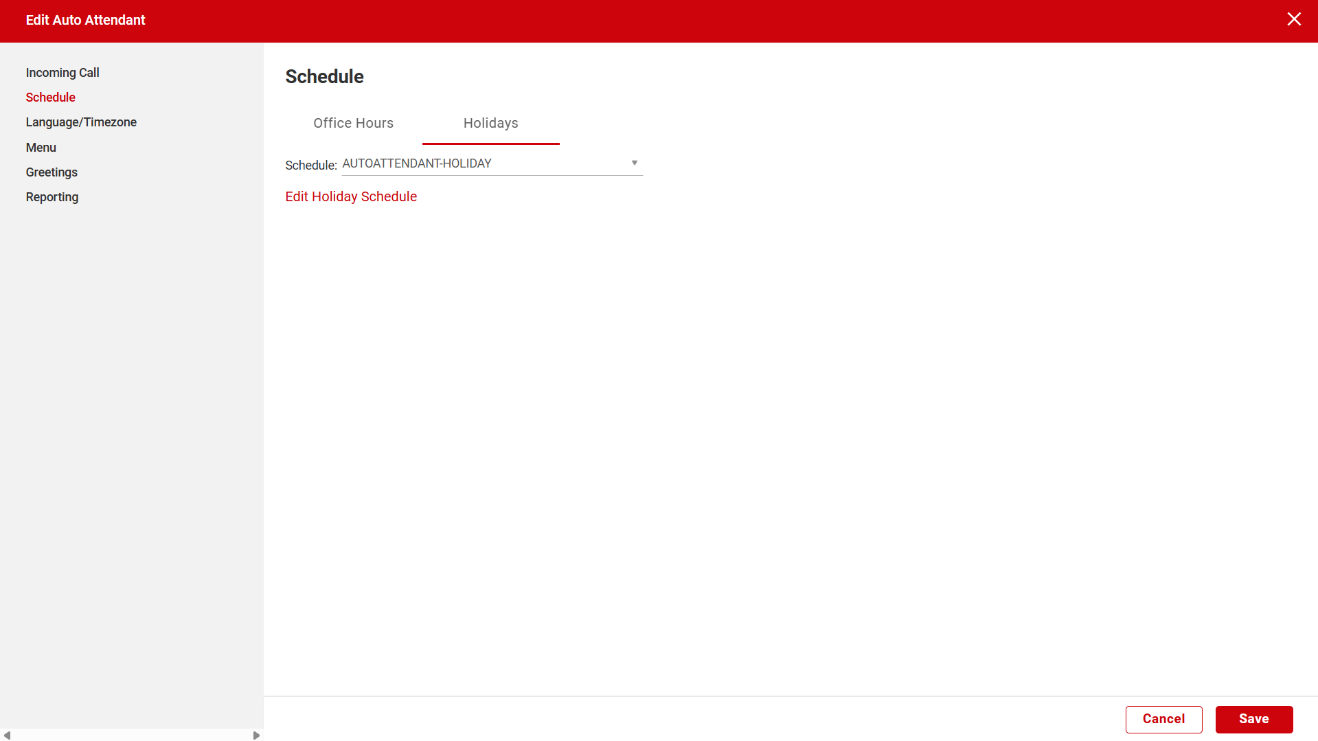

How do I configure a holiday schedule for an auto attendant?
You can configure a holiday schedule so that on designated holidays, the After Hours greeting and menu options are automatically played.
  1. Navigate to the Schedule tab in the left menu.
  2. Select Holidays.
  3. Using the Schedule drop-down, select the holiday schedule you wish to use.
  4. Note: The schedule options shown in the drop-down are configured within the Advanced Services area of the portal under Scheduling.
  5. If necessary, you can click Edit Holiday Schedule to modify the selected schedule.
  6. When finished, click Save to save the holiday schedule.
